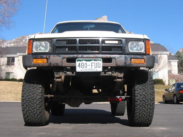

Has around a 3" lift springs.
33x12.5x15 BFG A/T's w/ full size spare

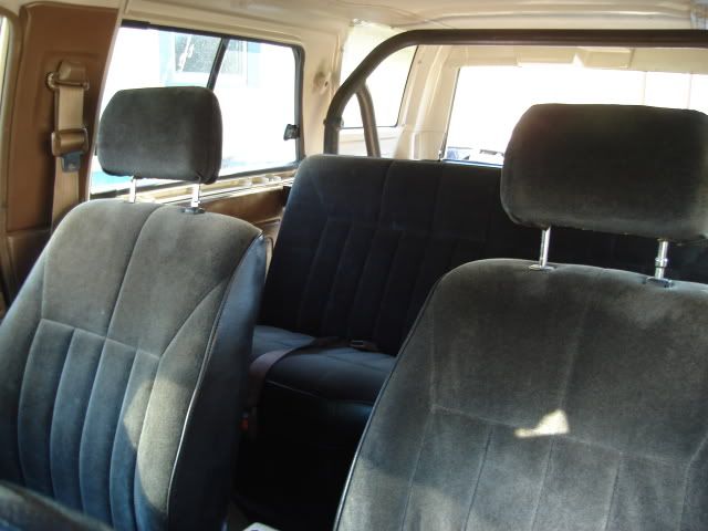

Reupholstered seats - actually pretty nice

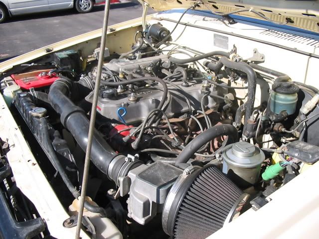

Nothing interesting new on this rig yet. I've been driving it and taking care of all the stupid little neglected shit that bugs the hell out of me.
So far I have:
Fixed a wiring gremlin going to the instrument cluster
Got the temp mix switch lubed up and sliding like butta
Installed the missing fan shroud
Fixed the driver side window regulator
Tightened both loose transfer case yokes
Topped off the t-case fluid
Replaced the rear-rear u-joint
Foamy engine brighted all the oily stuff and got the drivetrain looking like new
Cleaned all the tree sap off the windows and top
I need to order a timing set and cover and get those replaced since it's making noise at start up. After that I'll get all the valves set and timing right on.

My wheels showed up today so I got my 37x12.5x17 Cooper STT's mounted up on them. They are MRT 17x8 with 3.5" backspacing, non-reverse. I'm running 1.5" wheel spacers front and rear until I swap in the IFS rear then I'll be running them only on the front.
For some reason the drop center is really deep on them and they had to machine down the centers to fit. It looks kinda funny at first but I'll roll with it. The beads should be on there pretty damn good since it took 140psi and beating the sidewall with a sledge to get the outside bead to pop and seat all the way. That makes me nervous everytime!
I think there is about 3" of lift currently on it. I have no idea what springs they are but the front axle isn't moved forward and whoever put the rear springs on mounted the hangers about 2" farther forward than where they should be. This puts the tire really close to the front of the wheel well and tons of room out back. I think I will be alright once I swap suspension as far as any rubbing since I will be correcting the wheelbase. I plan on leaving it the same height it is at now.

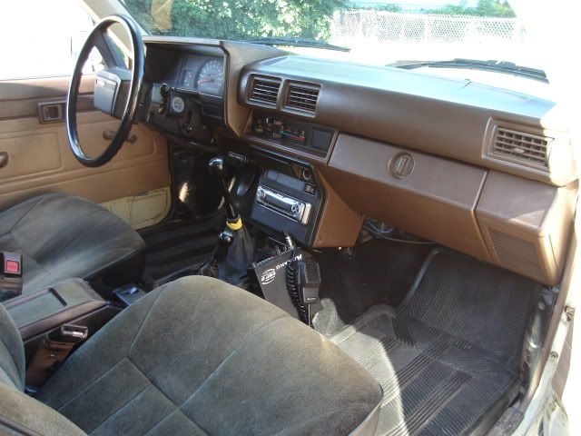

#13 ·
The whole interior has been reupholstered. It's actually pretty nice, I dig it. The front rubs at full turn but it should go away after I move the axle forward, it's about stock location right now. If not, I'll tub the front. It's hard to tell on the rear because the wheelbase is fucked up. Once the rear axle is centered in the wheel well I think it will be pretty good. I don't plan on running much for uptravel.

So you need a timing set already??? I would expect more than 10k miles out of a set. I guess they could have rebuilt the motor and re-used the timing chain\gears but that would make me wonder what other shortcuts were taken.
It's probably too late now but make sure they didn't put the wrong oil pump bolt in (top bolt which interferes with the tensioner movement). The first time I ever did a timing set this is what happened - of course I already had everything ripped apart before I realized this.
#16 · (Edited)
I swapped the new timing set and pump on yesterday. No more rattling at start up now :smokin: I know about that bolt so I made sure it's in the right spot. I don't know much on the history of the motor so changing is more for peace of mind. The one I pulled off looked like it was in good shaped, the guides were still good but the tensioner wasn't as springy as the new one. That motor runs really good.
