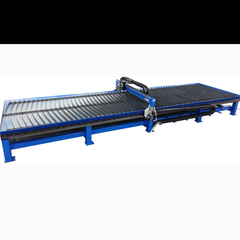

New for 2017 is our MEGA series Star Lab machines. We are able to make 8x40 travel Star Lab machines. But we also do 4x4,4x8,5x10,6x12 and 8x12.
Specs
Servo driven
Ultra fast response controller
MaxPro200 or Autocut200 (Hypertherm Powermax series can also be integrated)
1000ipm rapids
225ipm Z axis
Waterbed with angles sides
Up to 480"s of travel

Linear V rails
Torque is balanced to gantry weight/power requirement and acceleration speed
1000ipm
1000ipm
No need for reduction these tables have a perfect balance of speed and torque

Maybe a silly question but for me it's important. Is it OK to put casters on the frame for moving around? I have a very small shop and I keep wanting to pull the trigger on one of these and about the only way I can do this is to have it mobile. I guess the better question is how level does it need to be to work properly?
Yes you can easily put casters on a machine as long as the casters can handle the weight. You can have a pretty decent amount of unlevel area before these machines will even notice. Because of the way the motors integrate into the gear rack you shouldnt have an issue.
