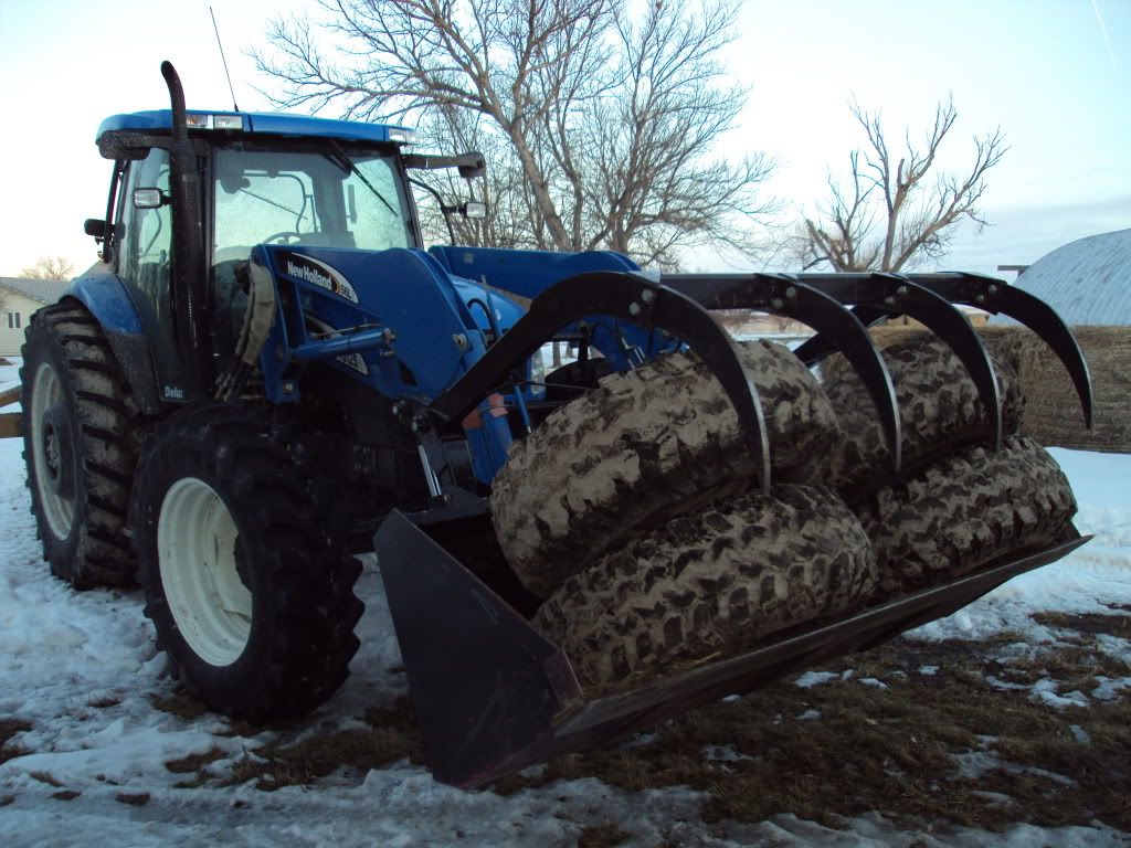

I am building a 79 f-150 with parts that I have already laying around. Plans include Shortened wheelbase to 124", flatbed, 466 BBF, 42'' iroks, C6 and 203, 12K lb winch, welded 10.25 rear, 60 front, shackle flipped rear, 6'' skyjacker leaves in front, ditching tractor pulls and going with fenderwell exits and flowmasters... I purchased the 79 with the intentions of pulling the C6 out of it to use in a shortbox mudracer (I bought the 79 for 400 bucks with a built C6). Note I did not paint this pickup:p the guy I bought it from evidently did not prep very well, he actually raced it a few times with the stock 400. I then decided I would just ditch the bed, trim the fenders, drop in my BBF, bolt on some 38.5 boggers, gut interior, install a racing seat, 5pnt harness and quicksilver shifter. I kind of thew it together in short order and now it has been sitting in my little shop for 2 years. The 60 front is coming out from my 70 f-250 that I had the 42'' iroks on. I need to get the 86 F-250 that has the 10.25 rear that I will be using when the snow melts some (it is still at the original owners place). So far all I have really accomplished is grind the rivets off and move the axle forward where it will sit. One thing I am kind of hung up on deciding is what rear leaves to use. I am not sure whether to use the rear 70 f-250 springs or the 86 f-250 springs. Here are a few pics.

42's and my ford cherry picker
