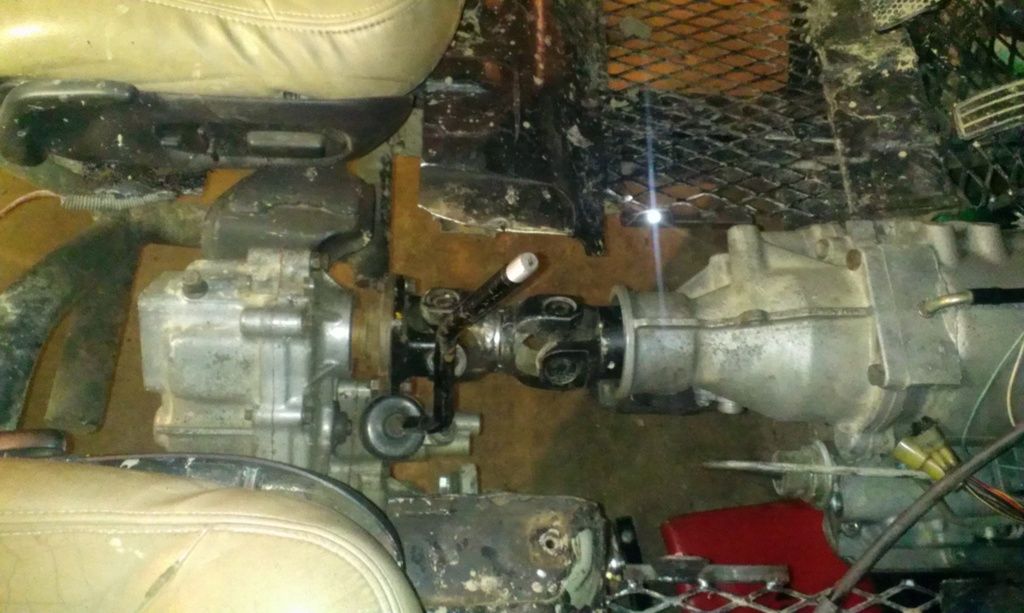

The 4 speed is a completely different animal. It's electronically controlled unless you have one of the full hydraulic variants. I had thought about going this route but for the price i am picking this trans and swap parts up for i couldn't pass it up. $200 for everything.
clemsonjeep, are you running the 4x4 or 2wd version? I am curious about the intermediate shaft lenth/angle. The rest will be fabricated (again...)

You're right about the 4spd. Although if I'd given the turbo any thought prior to the trans swap I might have gone that way. Then again I got a smoking deal on my setup too.
Mine is the 4wd version. Liked the idea of the slightly longer intermediate shaft.
#8 ·
I also like the idea of a longer intermediate shaft but for what i have into it and my current platform i have a bit of flexibility to make changes. My decision to go the 3 spd route is that i had already seen the aussie stuff even though its somewhat more durable. i had also seen the gearing advantage (auto vs. manual diff ratio). If it gives me issues it will get an AW4 (or variant) and dana 300. Honestly i feel like the weak point will be the transfer case. I am surprised the 5 spd is still in one piece considering it gets beat like it owes me money. not to mention more than double power of factory suzuki 1.3 at this point. thanks for the help folks. much appreciated :beer:

#16 ·
Mine is the 2wd. I made a custom short intermediate shaft and stock samurai t-case with the 6.5 gears, rockrat's spine with additional supports I added to custom t-case arms.

#24 ·
I made a stubby intermediate shaft as well. same basic yolk to yolk similar to what you did. Mine has 5 years and lots of high speed and road miles on it and its vibration free. My flanges and yolks were in real good shape and used the higher dollar oem style ujoints in mine.

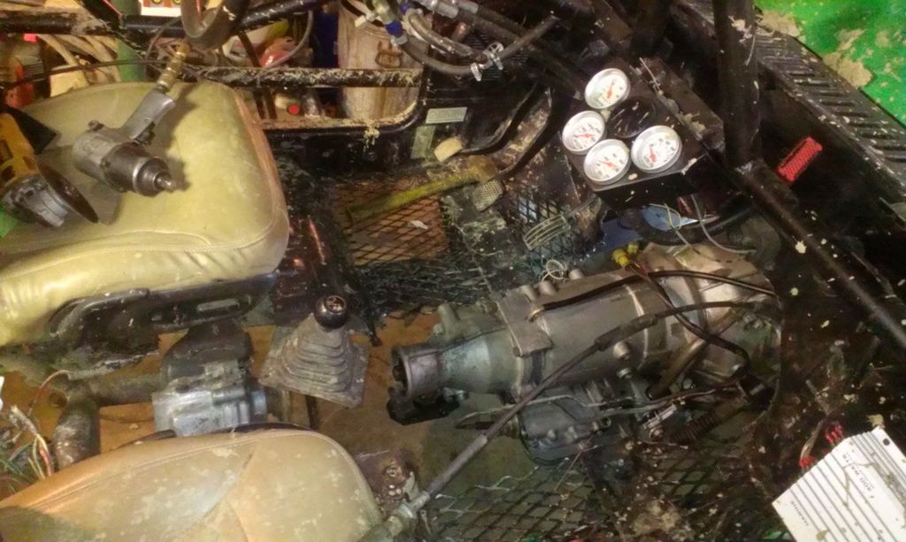

Since my motor was from a manual trans kick, I had to go to u pull it yard and find a double pulley part to attach to the throttle body so my tv cable can be hooked up. Length wasn't any issue. Its just getting it adjusted correctly so it functions properly that takes some time.
I also used the stock kick shifter. I also filed down the reverse gate so I can hit reverse quickly when needed. And it has its fair share of times used. I simply made a little box to cover it.

#37 ·
got a little done tonight, nothing spectacular. gonna have to modify the original shifter hole to make the tracker shift base plate fit. I may inset the rear some so the shifter is angled more toward me. I can reach it harnessed in but it's a stretch. I was gonna put it in the center tunnel but that would leave no room to mount my switches. not a huge fan of the stock shifter really but it was free with the trans. after i get the tunnels finished and bolted in gotta mount the cooler and fab the TV cable bracket and that should about do it. can't wait to get this thing back out!
