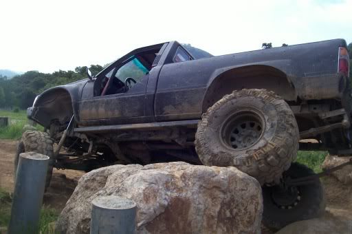

I picked this truck up about 6 years ago with a 4inch lift, 33's, and a blown head gasket. Trying to maintain a cheap budget my truck has been built with mostly parts off of my buddies truck's. Over the last year I have been making more money and there for my truck has been receiving a little more financial support. After spending the last couple of months rebuilding my frontend, new doubler and 4.7's, 38's, etc..... I flopped it onto both sides my first trip out. Since I just received a good size commission check I decided to dump some more money into the toy. I met Kyle from Driven Industries through a buddy of mine about six months ago and after seeing a number of his creations there wasn't any question where my tube work would be done at.

The Plan: What started life as a reg cab longbed will be transformed into a 4 seater (adding a rear bench), linked rear(18" travel air shocks, johnny joints, and ballistic brackets), and cutting the frame behind the cab. The 3" body lift will be dropped, width will be extended 3" wider, and frontend will be relocated forward by at least an inch. I want a rig that is very capable and still has enough storage to run the 'con for a weekend. So I told that to Kyle and since Kyle always is creating new bad ass looking rigs I have told him to do as he pleases with the tube work, with that in mind.
