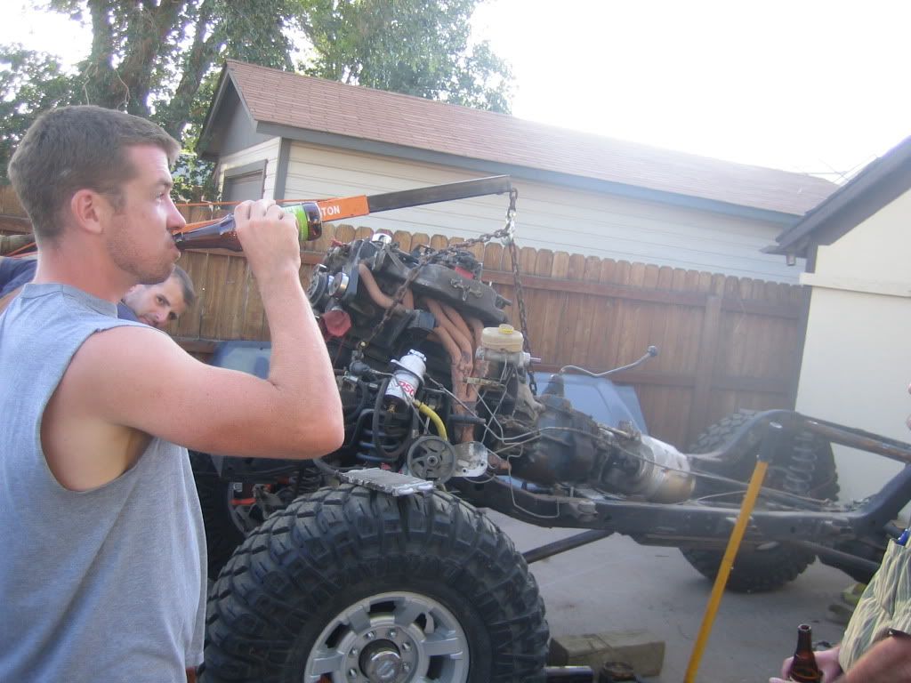

Going to try and yank the motor/tranny/tcase tonight after mountain biking. Everything is unbolted, just need to hook up a chain to the block, and pull her, hope to have some pics for ya if it's not too dark before bed tonight.

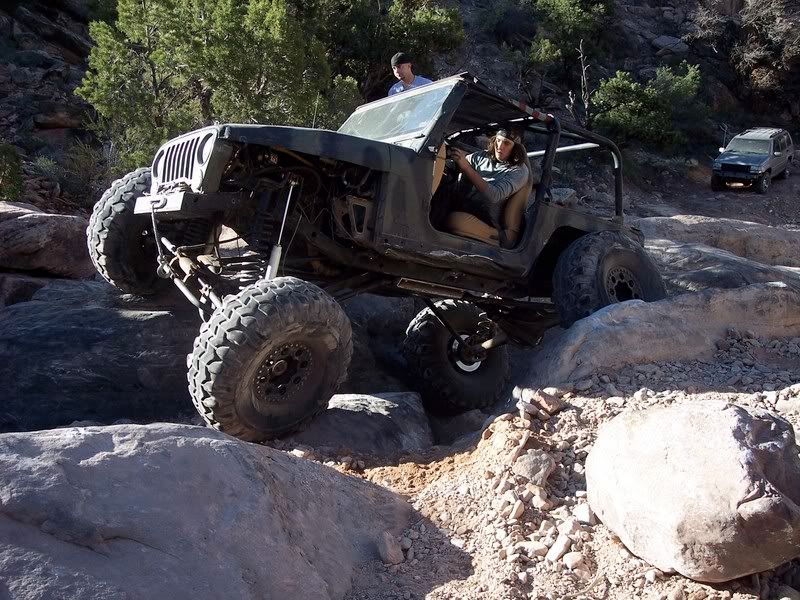

#17 ·
Yup, that's Nate Blehm's old Rig, i've known Nate for about 5 years now and have wheeled with him a few times, so am very familar with how the rig works, that's one of the reason's i jumped on it when i saw it up for sale :smokin: here's some pics of the last time i wheeled with Natey on Upper Helderado
This thing is stable & flexy

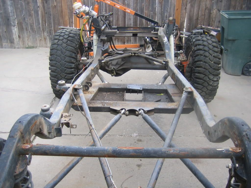

Made some progress this afternoon, since i don't have a torch, i started cutting all the old brackets off with my trusty 4-1/2" Dewalt Angle Grinder, and a couple packages of harbor frieght cut off wheels, it actuall went fairly smooth, i cut into the welds, then took out a steel wedge and sledge hamer and was able to break most off them off with out too much trouble. I started running low on cut off wheels, so rather than leave to get more, i tore into the dash and gutted it. Hope to wrap up tomorrow with the bracket removal, so i can start cleaning the frame up with my mr. flapper wheel that trailbuilt introduced me to last year building the CJ-5 :flipoff2: Here's todays progress.
Pass side all cut off, you can see all the brackets still on the drivers side
Went on to get most of the pass side except the front motor mount, factory upper control arm, track bar and orbital mount
Tub Gutted for the most part, still need to hit the substructure with the angle grinder to cut out some more.

Quick update, did a lot of B!TCH work. Started by using a 4-1/2" cut off wheel to cut through the welds of all the old brackets and misc crap that was still left on the frame, then where necessary, i used a 5lb sledge and a chisel to pry it off, then i proceeded to clean it up with a hard grinding wheel, and went back over it all with a flapper disk to try and make it look clean. As the old saying, it looks good from afar but far from good, as i did end up cutting a little too deep in a few spots, but regardless it's FAR better than just leaving all the useless stock link mounts, motor mounts, track bar mounts etc...In the mean time, i continued to the gut the tub, hope to have the tub narrowed tomorrow if all goes well, the frame is DONE for now.
Tub progress
Oh by the way, picked up a little bling, couldn't pass up a set of Polished Walker Evans that were on a street rig. They are absolutely SPOTLESS, thanks Sick99TJ :smokin:
Everything cut off and ground flush
Hit it with some primer rust stopper black paint to keep the rust away until i have a chance to give the frame a complete fresh coat of paint once all the new brackets are in.
